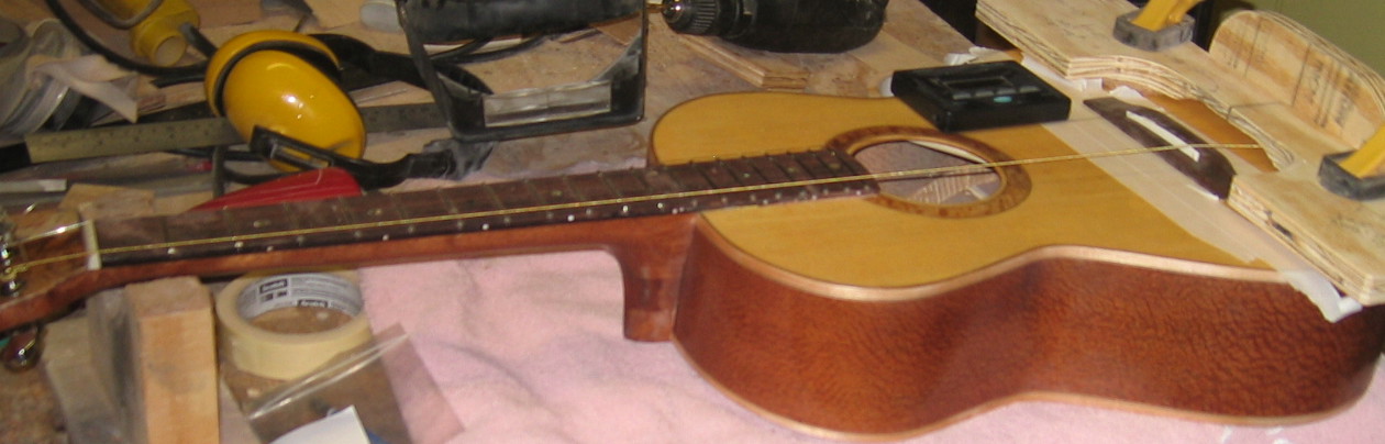

I made a tailpiece to do the intonation. Does anyone else do it this way? I can get the neck completely set up and on tight and then figure out the perfect bridge placement before I glue it down. The tailpiece anchors at the end pin and needs a little leather piece where it meets the body otherwise it will leave ridges in the binding. It works pretty well and you don't have to drill any holes through the top before gluing down the bridge.

[QUOTE=blegeyt] I made a tailpiece to do the intonation. Does anyone else do it this way? I can get the neck completely set up and on tight and then figure out the perfect bridge placement before I glue it down. The tailpiece anchors at the end pin and needs a little leather piece where it meets the body otherwise it will leave ridges in the binding. It works pretty well and you don't have to drill any holes through the top before gluing down the bridge.[/QUOTE]
That's an interesting idea Burton, I hadn't thought about doing something like that. I made a locating jig years ago that keys off the nut and 12th fret. Kinda like the SMac version except it has a dummy saddle in it that fits in the briidge slot and locates the bridge were I want it each time without fuss. It took a few adjustments to get it right but now it's a no brainer. It seems to me that once you get something that works, assuming your action will be close to the same each time, your intonation should be prety consistent. Mine seems to be anyway.

unfortunately my digital camera is gone this weekend so I can't get any photos, but it really isn't any different than an archtop tailpiece. Stewmac sells the fastener that wraps around the endpin and into the tailpiece. Thinking about it more though, I think John's jig is better. The tailpiece helps to establish the original length, but once you know it for certain strings I think his jig sounds much more easy to use. That made me think also, though, I have always assumed that different guage strings would affect the intonation. Does anyone set up guitars with the customers requested guage? or is the differences really so minor as to not be a real issue? I suppose too the width of the saddle matters. I have been using 3/32 but maybe 1/8 would give you enough room to track any strings..

I saw this jig on OLF the other day and thought it was the coolest. Built my own and used it for 2 bridge sets. It aligns and intonates in one step. Slider behind the jig has holes set to the saddle width ( plus the extra for the longer distance). Move it side to side to align. Move the bridge and saddle forwrd or back depending on intonation. I use high and low E only. Once satisfied,drill two register holes through the string holes on the bridge. Pin with the gluing bridge pins which do not stick to glue (StewMac). Take thi jig off, remove the finish, glue and clamp. I could not believe how simple this step could be.
